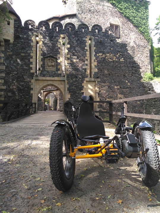

the meeting in Hungary is over, tomorrow we are going to a meeting in Poland
