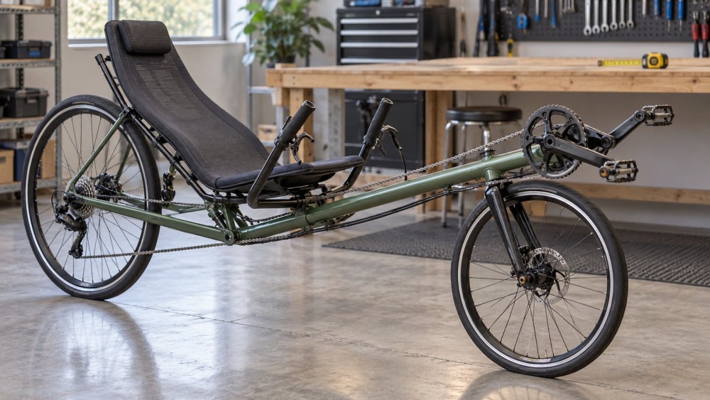

An AI drawing of a recumbent bicycle can make a design idea look settled long before its proportions are settled. The seat seems comfortable, the fairing has a neat line, and the wheels appear to belong to the same machine. Then someone asks where the rider's heels go during a turn. The attractive picture suddenly becomes a much less convincing design reference.
This is not a claim that a particular image model has failed a bicycle build. It is a caution about using any generated concept picture as if it were a dimensioned plan. The underlying image-generation complaint is broader: familiar objects can lose their normal scale when viewed from an unusual angle. A recumbent bicycle is especially unforgiving because small changes in wheelbase, crank position, seat angle, and steering clearance affect one another.
Consider an illustrative low-racer concept. The intended layout has a short front boom, a reclined seat, and a front wheel that clears the rider's feet. In a polished side-view image, the wheel may look correctly placed. Ask for a three-quarter view, though, and the front tire can creep closer to the crank while the boom stays visually short. The two images may share colors and styling but describe different machines.
I would begin with a few anchors that can be checked without pretending the image is a CAD drawing: wheel diameter, approximate axle-to-axle distance, seat height, bottom-bracket height, and the space needed for the rider's knees and heels. Put these values beside a simple side-view sketch. The sketch need not be elegant; its job is to protect relationships that a decorative rendering might change.
Then inspect the generated concept from two views. In the side view, look at axle placement, seat support, chain path, and the distance between the crank and front tire. In a three-quarter view, look for the same proportions and for steering clearance. A design that only makes sense from one camera angle should remain a visual mood board, not a build proposal.
An image workspace such as Grok Image 2.0 can be used to draft those visual concepts from text or to revise an existing image. That does not make either view mechanically consistent. Keep the measured sketch beside the output and compare the same wheel, crank, and seat relationships in each version.
A scale object also helps. A rider silhouette with a known inseam or a measured wheel gives the eye something firmer than “compact” or “long.” But even a scale marker does not guarantee structural accuracy: image generators may stretch a frame tube or hide an impossible joint behind a fairing. Treat any frame connection, brake mounting point, or chain routing as unresolved until a person checks it against a real design.
For a useful forum discussion, I would share the picture together with the intended dimensions and one explicit question, such as: “Does this crank-to-wheel clearance look workable at full steering lock?” That invites mechanical feedback. Posting only a beautiful render invites people to judge the paint and lighting.
The image can still be valuable. It can compare fairing shapes, color schemes, or luggage placement before anyone spends time fabricating a part. Its safest role is to communicate an idea for critique. The measured sketch and real-world clearance checks decide whether the idea survives.
Which single measurement would you insist on seeing beside a recumbent concept image before discussing whether it could be built?

Ketju ainakin toimii paremmin jo se ei ole poikki. Pedaalitkin olisi hyvä olla suurinpiirtein eripuolilla keskiötä. Ohjausliikkeen kuuluisi vaikuttaa pyörän geometriaan eikä olla kiinteä. Polkimet ei saisi ottaa erurenkaaseen kiinni ohjauslikkeen aikana. Myöskin takarunko on kummallinen jossa sekoittuu runkorakenne penkin rakenteeseen.
Mutta harvivaisen hyvä "kaunis" tekoälykuva.
